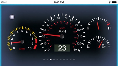

Uživatelský avatar iTukan | čtv čer 20, 2013 9:14 pm
Re: H: Autodiagnostika - aka app na OBD II?
Zkus jim napsat - *** If you have bluetooth OBD adaptor, please contact support@ksolution.org for instruction before you purchase this app.
https://itunes.apple.com/us/app/engine- ... 57194?mt=8
JInak ta app co pises je jen pro android.
17.11.2024 23:01
Velikost: 10 MB
Cena: US$ 5.99
Hodnoceni: 2.81967
od 61 lidí
K SOLUTION LLC
Engine Link - OBD II diagnosis 9.0
EngineLink will turn your iPhone/iPod into vehicle / car performance / diagnostics tool and scanner that uses an OBD II WIFI adapter or a low Energy Bluetooth adapter (LELink, LELink2, Carista, Viecar) to connect to your OBD2 engine management / ECU.
The only iPhone app does custom PID, now supports Torque custom PID file.
BENEFITS:
* Emission Test.
* See what your car is doing in real-time.
* Read and clear OBD fault codes.
* Display car performance and sensor data.
* Customizable gauges, showing only the data you were interested in
* Top Ranked Car App
* No in-app purchase and No subscription fees!
__________________
FEATURES:
+ Show and reset a DTC / CEL / fault code (current, pending and history) like a scan tool
+ Graph data
+ MPG widget to plot real time fuel efficiency
+ Heads up display / HUD mode for night time driving (mirror the display on your vehicle's windshield)
+ Can read Transmission Temperatures (vehicle dependant)
+ Horsepower/HP & Torque / acceleration
+ Boost / vacuum gauge
+ Engine speed / Engine RPM / Engine Load /Coolant / Fuel Tank
+ Customizable dashboard
+ Full configurable GUI with user choice of dial gauge, bar gauge, plot gauge, digital gauge, and on-off gauge as display elements
+ Full custom PID support.
+ Formula support.
+ Preloaded GM and Ford PID libraries
+ Preloaded standard PID library and Prius PID libraries .
+ User can add more libraries within the app or by using iTunes File Sharing
+ Multiple ECU support. Non-CAN, 11-bit CAN, and 29-bit CAN ECU bus types
+ Multiframe data support
+ Background color option
+ Email user log function (access by long pressing custom PID screen)
+ Multiple PID formula support
+ 0 to 60mph timer and quarter mile timer
__________________
EngineLink supports all OBD-II and EOBD compliant vehicles sold worldwide. If in doubt check with your manufacturer first or look for 'OBD2' on written on a big white label in your engine bay.
The app needs an ELM compatible Bluetooth Low Energy (for iPhone4s and later) or Wi-Fi adapter to work.
You can check Developer WebSite for Adapter Guide: http://www.outdoor-apps.com/enginelink.html
*** If you have Bluetooth OBD adaptor, please contact support@ksolution.org for instruction before you purchase this app.
Drop us an email for any suggestions/questions you may have at support@ksolution.org. We will answer.
