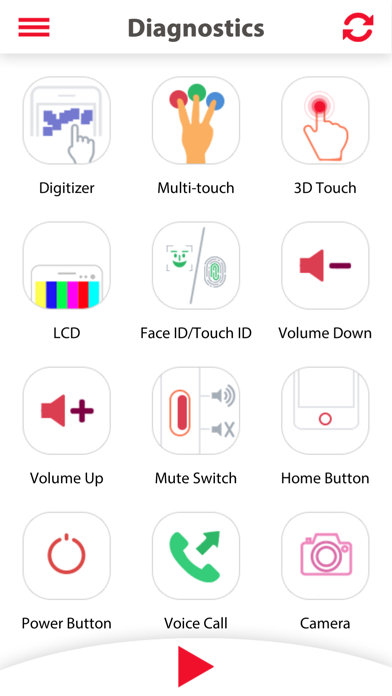

Prý není špatné toto
Phone Diagnostics od: HITEK_NOVAhttps://itunes.apple.com/cz/app/phone-diagnostics/id1171677218?l=cs&mt=8
15.10.2025 13:09
Velikost: 41 MB
Hodnoceni: 3.72619
od 84 lidí
HITEK_NOVA
Phone Diagnostics 4.0.7
Phone diagnostics helps the end user to easily test and check the functionalities of mobile devices before buying, sending to repair shop, or after repair.
It helps to find the repair shop near you.
This app can also be used by QC in repair shop or refurbish factory.
Most of the refurbish/repair factory is using manual QC process. The QC staff tends to skip/miss the test items and some items need several steps to perform one test case. With this app you can improve the quality and productivity of QC process significantly.
Contact us for factory version where all steps running automatically, ads are removed and the result is uploaded to factory shop floor control system. You will have real time data for analysis and improve the production.
It helps to facilitate the trade-in, enable the another life for the mobile device.
